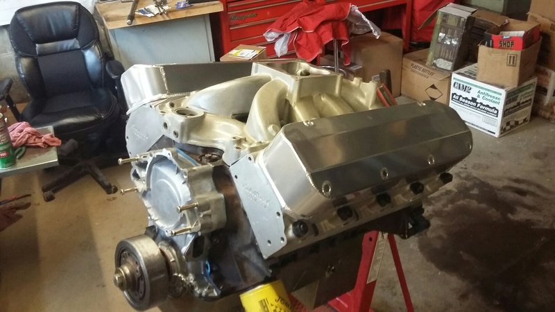

Post  5pointslow November 10th 2016, 2:21 pm
dyno next week any hp guess's ///rod picture damage and dyno sheet added  20161110
here is picture from the other day , put water pump on and painted engine and finished putting intake on afterwards
