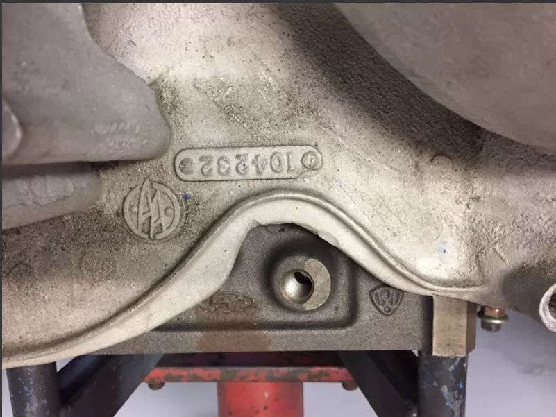

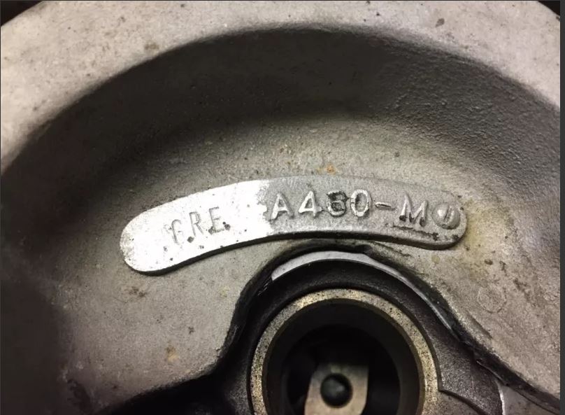

Im needing some help here to identify this manifold. I've just picked up an engine with TFS A460 340 heads but no manifold. There is one for sale here in Australia(pictured) but i've read somewhere that depending on what type of old style manifold it is, it may need some welding to match the ports.
Is this a TFS manifold? the only part number i could find online for these manifolds is M-9424-a460, which is the ford motorsport cast.

If the heads or manifold have not been milled anywhere ... it should fit fine.
Looks like it is already on an engine.

yes being that it is sitting on an engine with those heads you would assume everything is ok. I am still curious as to what version it is.
It is a Ford Motorsport version ... there was only one A460 manifold from them.
Ford Motorsport offered a smaller runner version with a different part number M-9424-B460.
