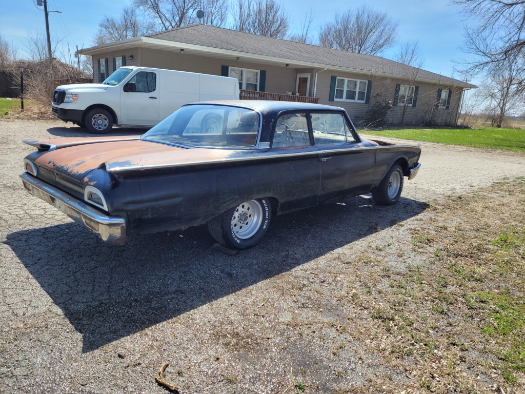

I'm currently working on several projects,  first is a 1960 Raven black base model Fairlane I'm putting together a 460 with mostly stock components for low boost or small shot of NOS,  as I don't have a T-56 6spd yet I'm going with a nice C6 and 2800 stall. The second project is a 78 Fairmount street car combinationNOS or Boost Img_2010

BOOST! I have a small nos shot on my stang. Its kinda boring actually.

Raven 1960 wrote:I'm currently working on several projects,  first is a 1960 Raven black base model Fairlane I'm putting together a 460 with mostly stock components for low boost or small shot of NOS,  as I don't have a T-56 6spd yet I'm going with a nice C6 and 2800 stall. The second project is a 78 Fairmount street car combinationNOS or Boost Img_2010
NOS or Boost Img_2011
NOS or Boost 20230410
_______________________________________________________________________________________
I like the nitrous for the ease of installation and low cost. A .073 nitrous pill in a cheater plate used to be listed as 150HP and 175HP on a Big Shot plate. I have found no problem with that HP level with OEM pistons, rods, cranks, ect. I consider that to be a pretty small shot on this size engine and as was said above kinda, I found a 125HP plate very lacking myself.
If you want to go Turbo on a Stockish 460 on a Budget the link below is a pretty good pattern in my opinion.
https://www.theturboforums.com/threads/65-mercury-comet-turbo-big-block.383732/
https://www.youtube.com/watch?v=CENciiR616Y
You mileage may vary and you can always change it up.
