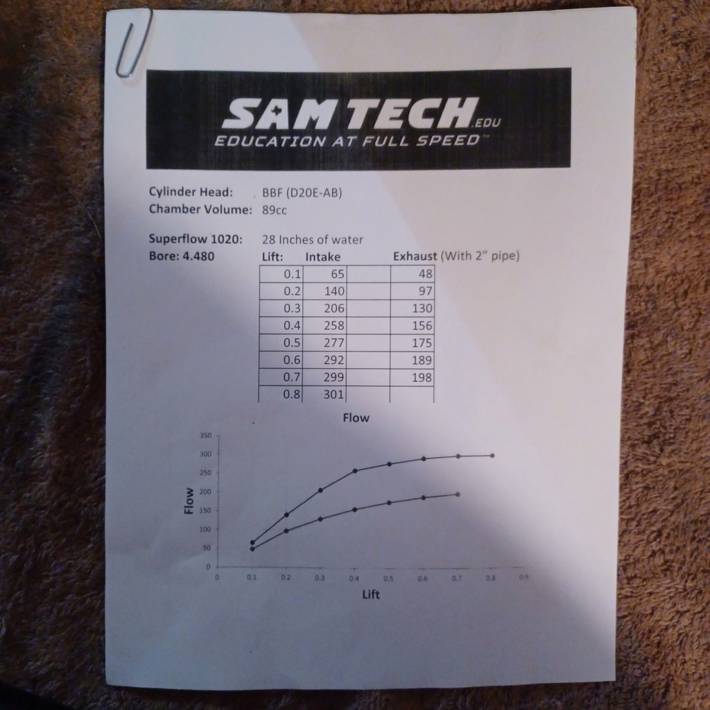

Intake and Exhaust Ported with Polished Chambers.
They Were Flowed with a 4.480" Bore Also, As a 4.36"-4.44" was Not on Hand. That Padded The #'s a Tad Up.
Nothing to Write Home About but, for Back in The Day They Were Pretty Good, Before all The Affordable Aluminum Heads Came Out.
The New SS Valves are Not Flat on The Bottom. They Likely Add About 3cc's to The Chamber Volume.
^ As For as I Know, They Were Only Cut Once, and That was .010" or Less.
I was Hoping for about 25Cfm More on Both Ports. They Flow Around What a Edelbrock Performer RPM Head Does, Which Flow About Like an Aluminum Pro-Comp Does.
Iron Makes More HP Then Aluminum, If You Have The Octane To Sustain The Compression and Heat, So There's That. Cool
D2OE-AB Police Interceptor Ported Heads Flow Chart 20231193
Hopefully They Run Decent. Flow #'s Are Just Part of The Picture and I Think They Will. The E/T is The Final Judge

Really Richard not bad at all .Just a comparison my AFRs flowed 319@.400and 356@.600 hopefully you will have some compression and that will give you some bottom end .Good luck Doug afro

I’m assuming you just blended everything, those numbers aren’t great for a full port job.
I’ve gotten Eddy well over 360 and iron CJ’s over the same with minimal work.

Hears what the heads ended up flowing. As you can see a quality performance valve job is worth its weight in gold, I have not touched the intake ports except for the valve job. The valve job that was on these appeared to have only 2 angles and a sharp ridge, but the portwork itself looked rather nice. Lesson here is you get what you pay for in a valve job cost of the valve job $225
it should also be noted the intake valves on the befor did not have a backcut and the after numbers java a light backcut Nd that is also contributing to the excelent intake flows.
intake before valve job / after valve job.
.100 75 / 75
.200 143 / 169
.300 221 / 260
.400 293 / 319
.500 325 / 360
.600 349 / 384
.650 356 / 388
.700 358 / 391
exhaust before, after number are affected by a big ridge that need to be blended out, I'll post numbers after I get after them as the after numbers with the ridge where about the same as before. I expect improvements into the low 200's after I finish blending them.
.100 55
.200 119
.300 167
.400 186
.500 186
.600 188
.700 190

dfree383 wrote:I’m assuming you just blended everything, those numbers aren’t great for a full port job.
I got Them Ported, Dave, for 400, Did Not Even Know They were Worked Over From The Pictures (Carbon, Ect. Covered The Port and Polish Work).

Neither set was ported. Street car performance was similar but you can get another 1/2 point of compression with aluminum. Those numbers on Dave's heads are stellar.
Stan Weiss's chart shows one set of ported D2OE's for comparison. If you've never been there take a look.
