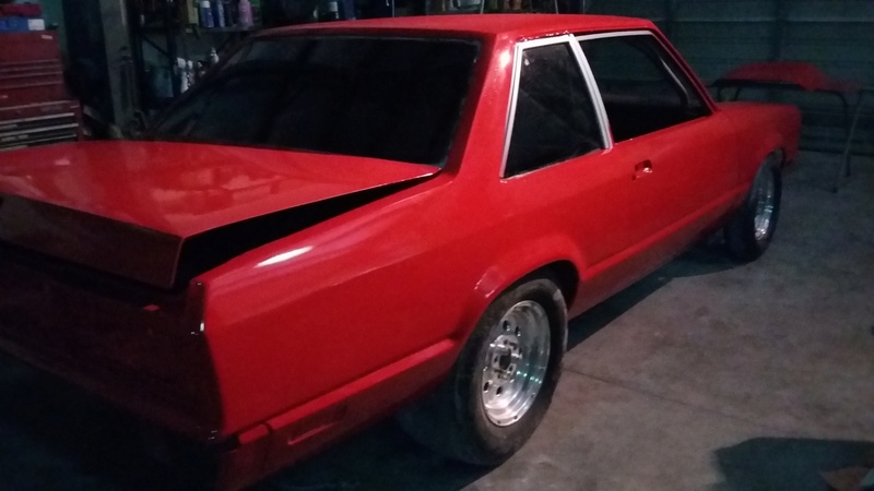

![Fairmont 472 Eddy head 649hp index car ......9.77 @132mph 10/31/18 *added videos - Page 2 Fairmo10](https://i.servimg.com/u/f11/18/28/83/34/fairmo10.jpg)
New paint needs to be wet sanded and buffed , nothing crazy nason base with cromax axalta clear .....new ford Race red color.
