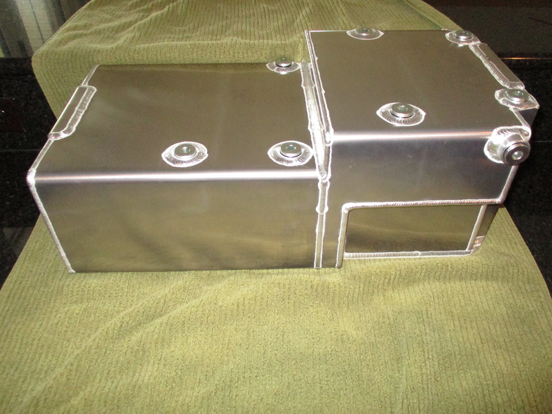

Dave De wrote:No main studs.... must be a front sump package with a pan that has a screen?
No screen door parts included.......only trays for me.
Re: AFR BBF Head
Lem Evans wrote:Dave De wrote:No main studs.... must be a front sump package with a pan that has a screen?
A work of art and functional as well. How does the oil pickup tube get supported?

Re: AFR BBF Head
That pan looks really nice! Not trying to hijack, but what's the best way to put one of those on with no outer pan rail visible and only the holes, I never had one before like this.

cobrakid8 wrote:That pan looks really nice! Not trying to hijack, but what's the best way to put one of those on with no outer pan rail visible and only the holes, I never had one before like this.
And very nice build Lem, you and Flip both know how to build one hell of a motor! Very good showing by the AFR heads also!
Nuts on short studs, VERY carefully, from the bottom with the engine upright.
Thanks Randy, sounds like I am going to have a fun time lol
