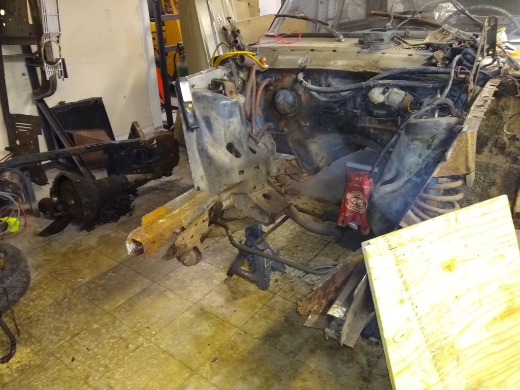

I started this over the past month or so.
The 260 was running, but I think the valves might have seized or lifters collapsed... So I yanked it to rebuild and do rust repair. 64 Fairlane restoration/ mods Img_2011

Yeah there is nothing available as far as the complex body panels for this car. Everything will be hand made.
These panels are not easy to make! Multiple curves and body lines are everywhere!
This car had some horrible work done to it... probably one of the franchise body shops.....
The car is surprisingly in ok shape for how long it's been sitting outside.
Anyway, it will get subframe connectors and metal repair. I will be putting on a tubular k member and a healthy small block.....big blocks are cool I just don't think it's in the cards right now.
The front end is removed for frame rail rust repair and radiator support replacement.
