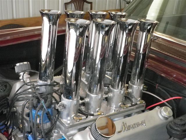

Post  Paul Kane April 20th 2022, 2:35 pm
blykins wrote:Does anyone know if anyone ever made a mechanical injection setup (think Algon, Hilborn, etc.) for a 429/460...regular head?
There was a guy just a few years back, somewhere in Oregon, who was piecing together complete mechanical stack systems made to order, using our front cover & hex drive, a Blue Thunder intake manifold, etc.
Here are a couple of pics:
Stack Mechanical Injection Mechin10
Stack Mechanical Injection Mechin11
Not sure where he is now or what he might be doing, or if I could even find his contact info, but you might be able to put together something similar yourself. Idea
